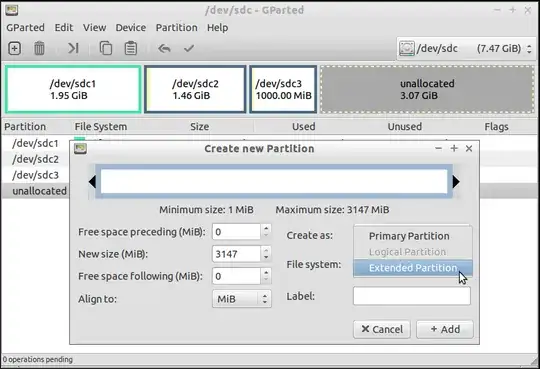

creating an extended partition
Right-click on the unallocated space (either in the horizontal bar representing the disk, or in the list below it) and clicked New.
  • Or (left) click on it and click Partition > New in the menu.
  • Or (left) click on it and press the Insert key.
That brings up the window shown above. Click to the right of Create As and select Extended Partition. (By default it will be Primary Partition, which is not what you want.)
Make the extended partition the maximum size.

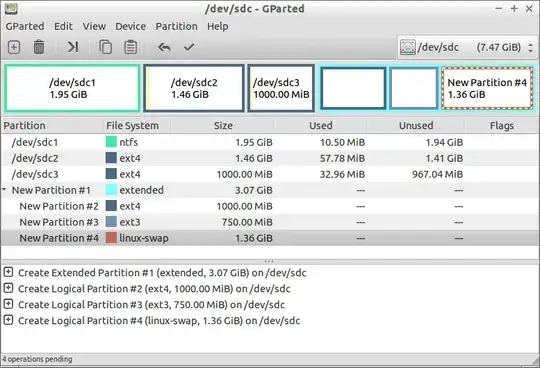

When you have done this, it will look something like this (and then you can click the check mark in the toolbar, to do Edit > Apply All Operations, to apply your changes.
GParted screenshot showing partitions to be created inside an extended partition

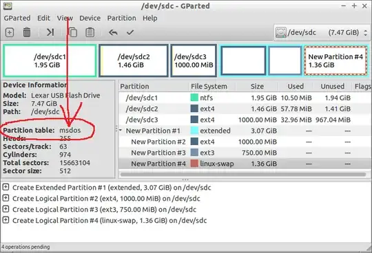

Another way is to check directly in GParted. To do this, click View > Device Information. A **Device Information* pane will appear to the left of the list of partitions, under the horizontal representation of the disk.
GParted screenshot showing that the partition table is of type msdos

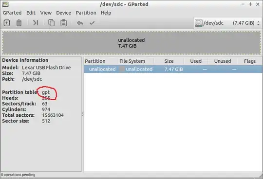

In contrast, if you have a GPT disk, you'll see "gpt" instead of "msdos." (There are other types of partition table as well, GPT and "msdos" are just the most likely, on a PC.)
GParted screenshot showing that the partition table is of type gpt
