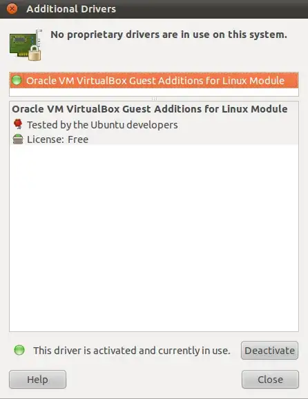

3D acceleration in Virtual Box still is experimental. Therefore not all combinations of hosts/guests are supported, some graphic funtions are not yet implemented, and some incompatibilites with the host graphic adapter still exist. In addition virtual emulation of a 3D graphic card consumes quite a lot of CPU power and slows down the guest system considerably.
In order to test 3D functionality you have to enable this manually in the settings of your virtual machine. Also a proper installation of guest additions is needed. You can test the latter in the guest Ubuntu from System -> Administration -> Additional Drivers. The guest additions driver should appear there as activated like this:
If you can't see this you need to reinstall your guest additions by running the installation script provided by the guest additions .iso file (see also this answer).
