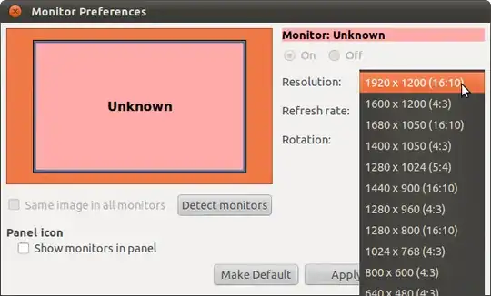

None of the options in the Systems -> Preferences -> Monitors fit my display perfectly. I need it at 1080 x 1920 (9:16) or 1920 x 1080 (16:9).
Many different resolutions work (see screen-shot bellow), among which are:
  • 1680 x 1080 (too narrow horizontally and a bit too short vertically)
  • 1920 x 1200 (perfect horizontally, but a bit too tall vertically)
How can I adjust the screen resolution (display/monitor size) manually?

The 2 new resolutions do not show up in the Monitor Preferences GUI: enter image description here

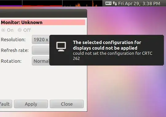

In both cases I can't switch to that resolution and get:
  • Could not set configuration for CRTC 262
All the other resolutions work.

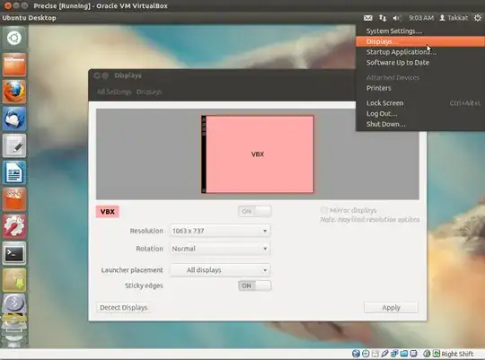

2. Use predefined standard screen sizes
If you need a fixed (standard) resolution you may also choose System Settings -> Monitors (for 11.04) or Displays (for 12.04) for a selection of fixed resolutions (here shown for 12.04):
  • For maximum host screen resolution you will need to run Virtual Box in Fullscreen mode (Host + F)
  • For a fixed host screen resolution we need to disable Auto-resize Guest Display (HOST+G) from Virtual Box Manager View menu.
3. Define new geometry with xrandr
If you need a fixed geometry that is not in the list of resolutions for monitors you will have to use xrandr to define a new resolution:
First we use gtf for calculating the modeline of possible resolutions:
gtf <xres> <yres> <refresh> [-x]
Give the desired values for x-resolution, y-resolution and refresh rate. The flag -x is default and can be omitted. For a portrait resolution 480x640 at 60 Hz you will get the following output:
$ gtf 480 640 60 -x
$ 480x640 @ 60.00 Hz (GTF) hsync: 39.78 kHz; pclk: 24.82 MHz Modeline "480x640_60.00" 24.82 480 504 552 624 640 641 644 663 -HSync +Vsync
From this we can copy & paste the modeline to add it to xrandr list of known resolutions:
xrandr --newmode "480x640_60.00" 24.82 480 504 552 624 640 641 644 663 -HSync +Vsync
and add this for the Virtual Box Monitor:
xrandr --addmode VBOX0 480x640_60.00
Replace VBOX0 with the appropriate monitor if you have setup Virtual Box with multiple monitors (or any other output name the driver reports).
We can now switch to the newly defined geometry as described above (2.).

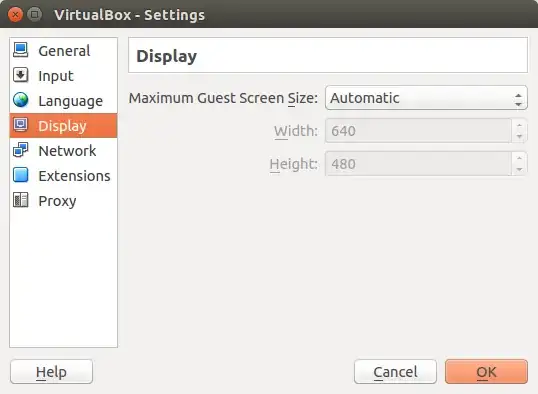

I had this problem with Windows8 (Host Ubuntu). It wouldn't scale to the external monitor's size.
In the Virtualbox, File, Preferences [CTRL]+[G], Display, choose Maximum Guest Screen Size - Automatic.
Solved. VirtualBox - Settings
