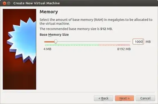

  3. Set your Base Memory (RAM)

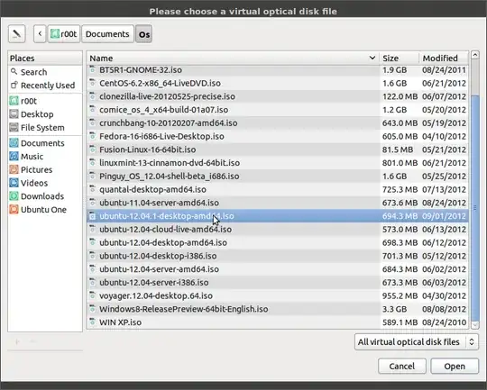

  5. On VirtualBox main window, select START and pick your MEDIA SOURCE. In your case, select the .iso on your desktop.

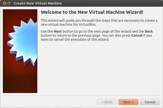

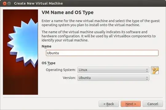

Open Virtualbox and click at New button.
Setup Wizard will appear and click at Next button.
Enter your Virtual Machine name, and choose your guest OS and architecture (32- vs. 64-bit) from the dropdown menu and click Next button.

Enter memory (RAM) to reserve for your virtual machine and click Next button.
Leave enough memory to the host OS.

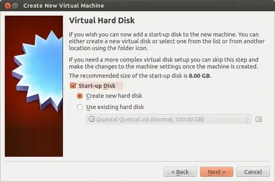

Tick at Startup Disk and Create New Hard disk and click at Next button.

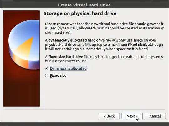

Enter the size of your virtual disk (in MB) and click Next button.
A dynamically growing virtual disk will only use the amount of physical hard drive space it needs. It is better to be rather generous to avoid running out of guest hard drive space.

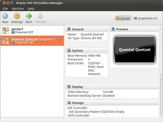

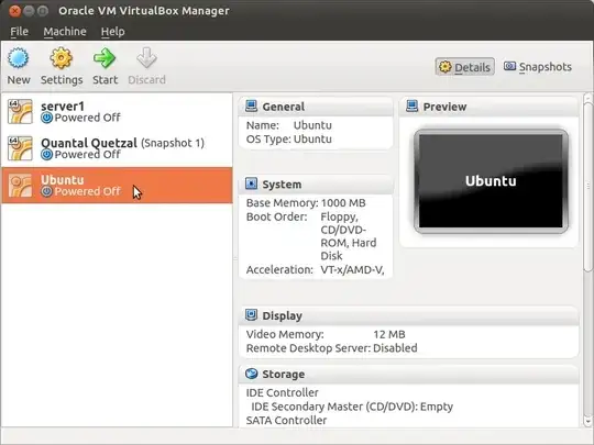

The "New Virtual Machine Wizard" will close and back to VirtualBox Manager. Select your Virtual Machine and click Start button.

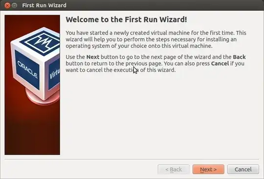

"First Run Wizard" will appear and click Next button.
Click at 'folder' icon and choose your Ubuntu iso directory.
Select your Ubuntu iso file and click Next button.

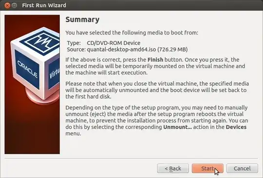

In 'Summary' box, click Start button.
This screen will appear when it start boot.

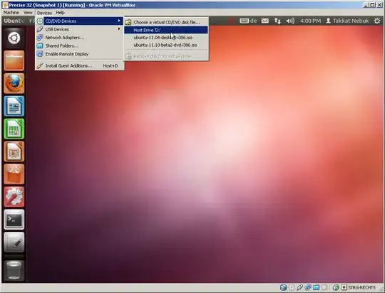

After a successful installation we have to remove our installation .iso image from the virtual optical drive before we reboot. This can be done from the "Devices" menu or by removing the .iso from the VM settings:

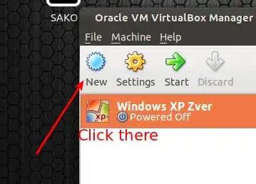

  1. open virtualbox
  2. than click New

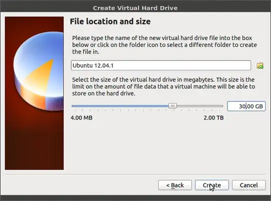

  5. Set memory f.e. 1024 MB
  6. Select Create new hard disk
  7. Select VDI then Next
  8. Select Dynamically allocated then Next
  9. Set location(let it stay its default) and its size (f.e 20GB) then Next
  10. Then Create

  13. Start VM

  7. Set memory size for Ubuntu (8GB [8192 MB] or above, depending on what you will use the VM for) - click Next
  8. Select Create virtual hard disk now - click Create
  9. Click VDI (Virtualbox Disk Image) - click Next
  10. Click Dynamically allocated (less space required) OR Fixed size (faster install) - click Next
  11. Set filename and Size for the virtual disk (this image file will be the first harddisk of the virtual machine) - click Create
  12. Ubuntu_20_04 is selected in the left side pane - click Settings (icon, upper row in VBox window)

  14. click the CD icon to the right of Optical drive, a menu appears, select Choose a disk file and select the ISO file you downloaded in step 2.
