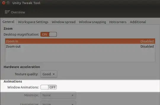

Disable animations with Unity Tweak Tool or Gnome Tweak Tool
With both tools we can disable desktop animations:
GNOME tweak tool
Unity tweak tool

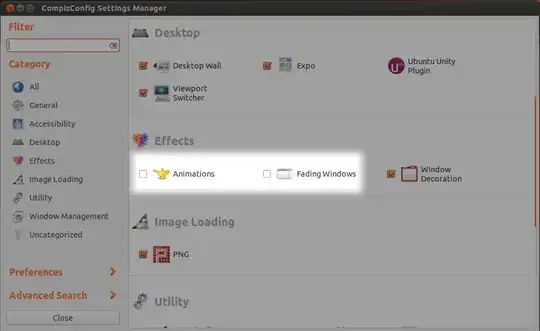

Compiz Config Settings Manager
As this is a virtual machine with the option to make a snapshot before you do harmful things to your OS you may probably safely runs ccsm to disable Compiz effects:
Do not disable windows decoration above

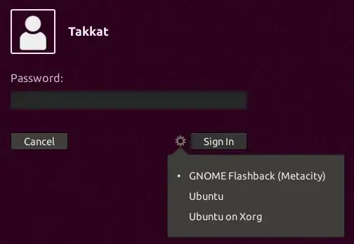

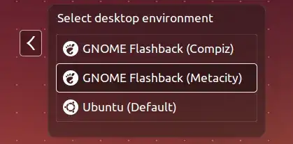

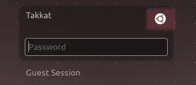

GNOME Session Flashback
In the likely case you are still not happy with the overall speed of the desktop you may consider installing the GNOME Session Flashback, which will let you log into GNOME Flashback (Compiz or Metacity) with a lean and fast desktop reminiscent of 10.04, but with all the upgraded applications, and the recent kernel:
Login 16.04
Login > 17.10
