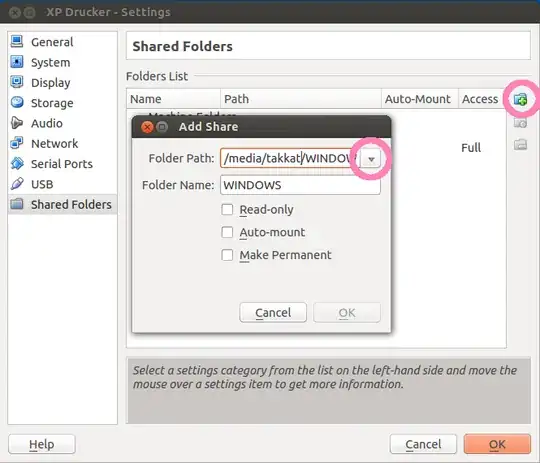

This is how to quickly gain access to a Windows folder on the host machine:
  • Install Guest Additions in Virtual Box to have "Shared Folders" access.
  • Mount the Windows partition on the host.
  • Define a "Shared Folder" from Virtual Box Manager (Devices > Shared Folders...)
  • Mount the shared folder in the guest OS (for Windows guests use Network settings).
Note: booting an existing Windows from a physical hard drive is not recommended in Virtual Box.
