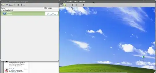

The other option is virt-manager which is a gui for kvm.
sagarchalise
  • 24,306
