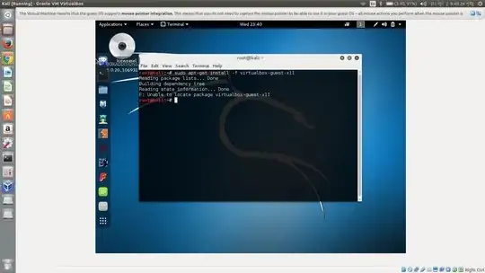

I am using a full fresh installed Kali Linux rolling edition. And please be specific to me while explaining the matter because I am very new-be in the world of Linux. My host OS is Ubuntu 15.10.
apt-get install virtualbox-guest-x11 apt-cache apt-cache

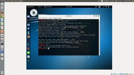

Simple and easy answer:
First install the needed dependencies you need to build the modules:
apt-get install linux-headers-amd64 dkms
Then install the gues additions with:
sh /media/cdrom/VBoxLinuxAdditions.run
this will take care of everything normally. The VirtualBox Guest additions are not within the Kali repository so you cannot install them with apt-get, but since you mounted the additions CD anyways (as seen in your screenshot) this above command will take care of everything.

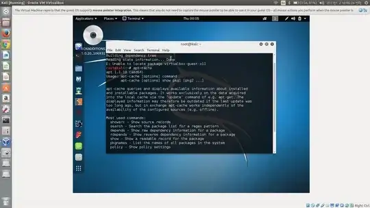

Looks like your guest is missing DKMS support , this would allow it to easily build the modules for the virtualbox guest. On ubuntu you can install guest tools from these packages, not sure if Kali does this the same way.
sudo apt-get update
sudo apt-get install dkms virtualbox-guest-dkms
