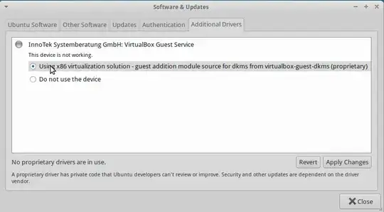

open up a terminal and run this command to open up additional drivers.
sudo /usr/bin/software-properties-gtk --open-tab=4
Click on Using x86 visualization solution
Then click on apply Changes
If you wanted to Install this in terminal you would need to run this command.
sudo apt-get install virtualbox-guest-dkms
