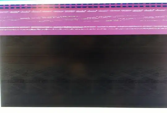

The last check that is run is "Stopping System V runlevel compatibility [ok], and a bunch of Starting [ok]s. Then I get a black screen, then a half purple half black screen graphical error. Sorta looks like snow, I don't know how else to describe it. After a while. That goes away and is replaced by a black screen again. Nothing else happens.
