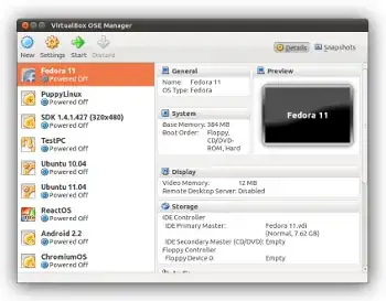

At this point you will be presented with the VirtualBox main window:
     * Click for larger image
Note that in the screenshot above, I already have a number of virtual machines - since you are just starting with VirtualBox, you won't have any yet. To create one, click on the "New" button in the toolbar. You will be presented with the "New Virtual Machine Wizard":

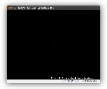

Your new virtual machine is ready to boot! Simply double-click its entry in the main window on the left and it will (hopefully) start:
You'll have to wait a minute or two for your new OS's installation menu / installer to load. To interact with your virtual machine, simply click inside the window. VirtualBox will display a dialog explaining how capturing the mouse works.
