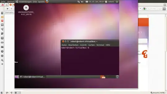

I have Ubuntu both as guest and as host. I use VirtualBox 4, just downloaded from the official repository. After installing the guest extensions, I got this strange problem:
When I activate the resizable screen mode with Host + C, the GNOME desktop won't resize with the screen. Only the wallpaper gets stretched. I use no desktop effects and haven't changed any driver options yet.
Any ideas how to fix this? Here is a screenshot of the guest machine, demonstrating how it looks like after changing the resolution:
I know how to use scalable mode, but I guess I forgot some configuration in the guest machine to make it work.

Virtual Box Scaled Mode (Host+C)
Virtual Box has the option to run in "scaled" mode. This means that any screen size will be enlarged or reduced by the same factor as the host windows size changes. The scaling also effects desktop elemets that may be rendered distorted then:
VBox scaled

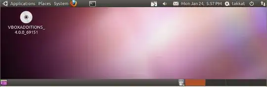

Virtual Box Non-Scaled Mode (Host+A)
When Guest Additions are installed (see this answer), and only then, we are also able to fit the guest desktop to an altered host windows size. Desktop elements will then be rendered correctly to fit into the virtual desktop size.
VBox non-scaled
Pressing the key commands switches the given feature on or off.
