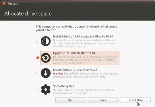

In addition to an online upgrade we now have the additional option to upgrade an existing system by using the installation CD-ROM image. After choosing Install Ubuntu you will have the option to upgrade your system by keeping your personal data and system settings:
A similar option will also be available when booting your upgraded Ubuntu 11.04 from the installation CD-ROM image of 11.04. By this you may be able to reinstall or repair your Ubuntu without deleting data and settings in /home.
