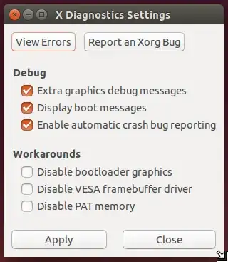

After having first tried installing the Guest additions, which didn't work, I found another solution elsewhere: linuxbsdos.com.
Use Xdiagnose from the Dashboard. Search for and launch Xdiagnose, then enable all the options under the Debug section. Click the Apply button, then close the window and restart the system.
That's what finally did the trick! Now I get 1024 x 768 resolution instead of 640 x 480.
I never uninstalled the Guest additions, so it might be I needed to take both these measures.

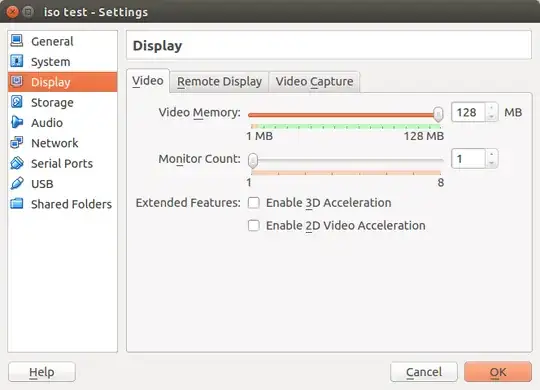

I had the same problem. I fixed it by installing the guest additions as explained in the other answers and jacking the amount of video RAM in the settings as shown. MateConfig
