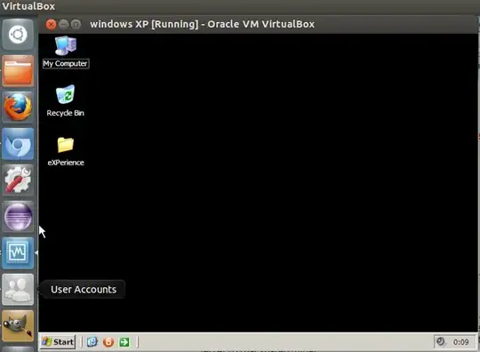

I have installed virtualbox 4.1.18 on Ubuntu 12.10 and I hosted windows XP.
I want to share a folder between Ubuntu and Windows XP, so I have read about it in this external tread.
The problem is when I'm trying to access to the Install Guest additions option I can't find the Devices menu, when I'm focusing the guest machine.
screenshoot

The solution is to press the following keys: Host+C

open a terminal and enter the command below to install It for VirtualBox 6x then reboot the vm
sudo apt-get install virtualbox-guest-additions-iso
