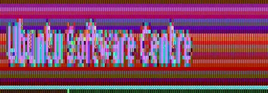

I recently installed virtualbox Ubuntu on host Windows. I am new to Ubuntu and virtualbox. I made two changes and I would like help to understand which one (and why) it messed up Ubuntu.
  1. I had downloaded an email attachment file 5MB large. I kept getting an error that the disk space was running low. I allocated storage 8GB at start (dont know where it has gone!)
  2. The screen resolution was like 640X480, so I adjusted the virtualbox-guest-dkms option, and it got fixed.
I restarted the guest session to effect the changes of the sizing. Now I am getting a pixelated screen for the login.
When I enter the password, I am able to get into the machine. I know this because the screen pixels change to what the desktop must be looking like.
There is a possible solution listed here that might help with a messed-up screen like that.
Press Hostkey+F1, then Hostkey+F7. The first will switch to a terminal, and the second will switch back to the desktop. Apparently, that forces some sort of redetection of the graphics setup.
(Hostkey is the right Ctrl by default.)
(Make sure the keyboard is captured.)
I also had to reboot the VM after that, for some reason.

I have had a similar issue with my Ubuntu 16.04 guest installation, I received this advice:
Disable 3D acceleration until you get the guest installed and have also installed the guest additions ( in the guest ). Then do a full power down of the guest, enable 3D acceleration and see it that helps.
Taken from the answer I got when posting my issue here: Link to Virtualbox Forum Thread
Perhaps your issue has to do with 3D acceleration too, try turning it off?
