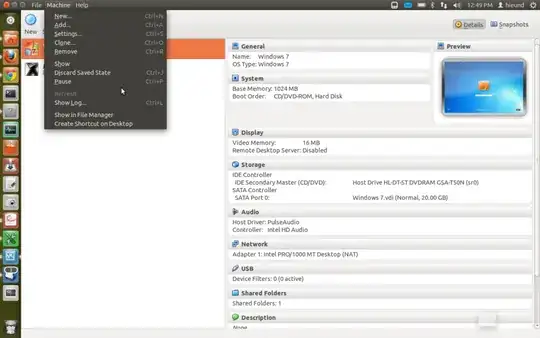

I want to install "Guest Addition" for my virtual Windows 7 but I don't see Devices menu. Why? enter image description here

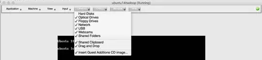

You can activate 'Devices' menu via View -> Menu Bar -> Menu Bar Settings.

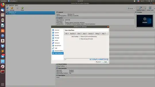

Just go to user interface in Machine settings and mark devices so devices background become gray then restart your Machine and you will see Devices on the Menu bar.
Works for all options you need to see on Menu bar.

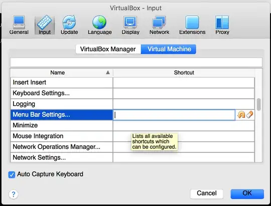

I faced the same issue with MAC host and Ubuntu guest. Finally, I found this:
  1. Go to preferences.
  2. Select input → Virtual Machine
  3. Add shortcut key to Menu Bar Settings (I added HOST key + M)
    VirtualBox - Input dialog
  4. Click OK and go to running virtual machine and press the key combination for Menu Bar Settings. Then you can see the menu at the top of the screen

This works if your host machine is Ubuntu 11.10:-
When your virtual machine is running and is the active/focused window. Look to the top left of your screen, it should show "VirtualBox".
Move your mouse over the x in "VirtualBox", then you should see the Devices menu.
