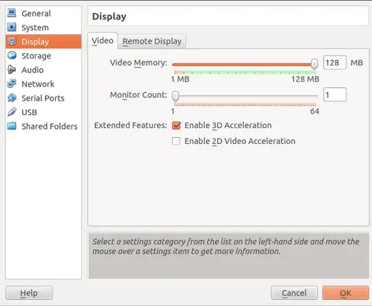

  • Make sure we have 3D-acceleration enabled in the virtual machine settings, and allow enough of video memory:
