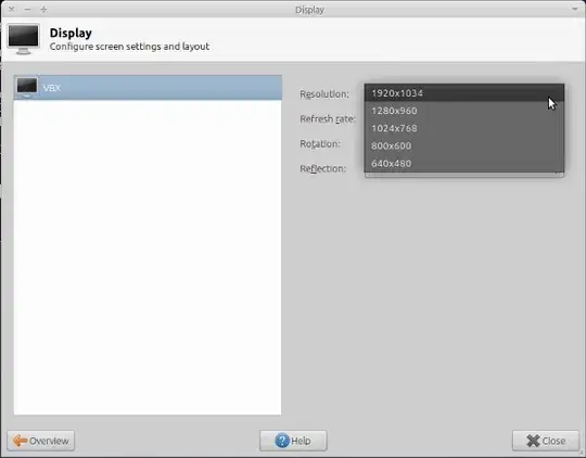

After having installed the Guest Additions (which involves mounting of the Guest Additions iso in the guest OS and running the installation script as root) we are able to change the virtual screen resolution either by the Display Settings
or, when Auto-Resize Guest Display (Host + G) was enabled from View menu in the Virtual Box Manager, by dragging the guest OS windows with the mouse to the desired size (this resulted in the odd resolution 1920 x 1034 depicted here).
To find out if the virtual graphic adapter from guest additions was loaded we can in the guest OS issue
lspci | grep VGA
This should give us
VGA compatible controller: InnoTek Systemberatung GmbH VirtualBox Graphics Adapter
If that is not the case you my want to try installing the guest additions again. You may also want to update your installation of Virtual Box on the host.
