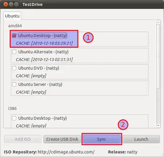

1. Obtain latest image
You should do this with testdrive Install testdrive.
TestDrive
Note. If your key is smaller than 4.4 GB (for Ubuntu 11.04 (Natty Narwhal)), you must get the alternate installer. The Desktop installer refuses to continue if there is less than 4.4 GB of free disk space.

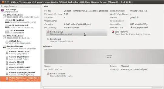

2. Format the USB disk.
This is important if you already have anything looking like a Linux install on your disk, or the installer will not want to touch that disk, for some reason. I failed earlier because I didn't perform this step, so skip at your own risk! You need a key that is at least 3 GB in size.

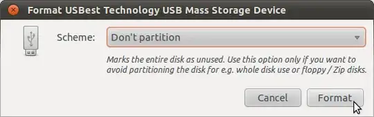

You can do so from SystemAdministrationDisk Utility. Choose the destination USB key, unmount all partitions, and select Format Drive.
Disk Utility
You need to make sure you select "Don't Partition" before it lets you format the disk.
Format drive window.

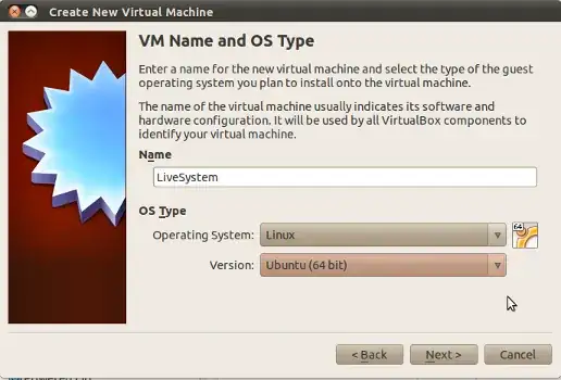

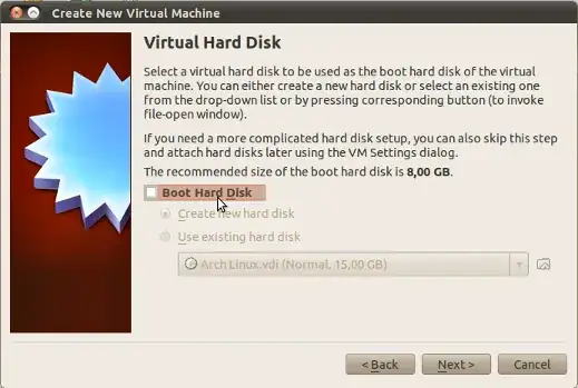

Create a virtual machine for the installation live environment:
We create a virtual machine for a Linux/Ubuntu environment (32- or 64-bit, depending on the installation medium):
As we want to install to an USB drive we do not create a virtual harddisk (VDI) for this machine by unticking the box in the following window:
We then need to assign system memory (e.g. 1024 MB), graphics memory (e.g. 128MB), and adjust CPU settings according to our host hardware. Also we may want to create a bridged network in order to be able to download files during the installation.

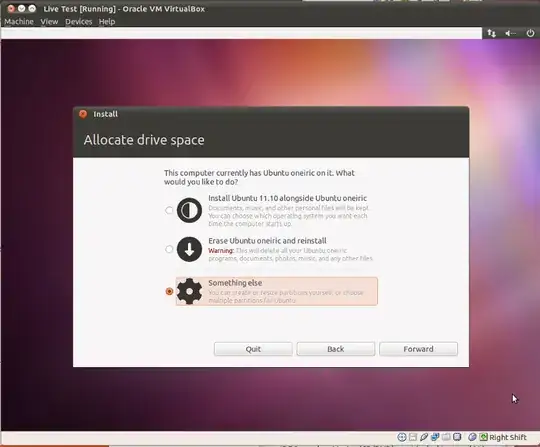

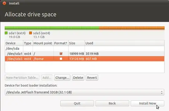

Partition and format the USB drive
After having chosen Something else the graphical partition manager GParted will guide us through the partitioning process:
We need at least a partition with a mount point root (/). In the example above an additional /home partition was created. By unticking Format we keep the data that may already be there. A /swap partition may not be needed for an USB-stick or a portable drive.
  • At this point take extra care that the boot loader Grub indeed will be installed to the USB drive (/sda) and not to anywhere else
By selecting Install Now we start the installation to our USB drive. Consider that this installation may take a bit longer than we are used to.

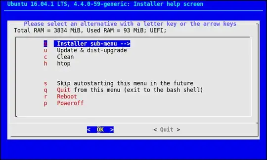

Step-wise instructions for installed system in a USB drive
Introduction
The main part of this step-wise instruction is borrowed from the iso testing tracker and this link,
and I have added some extra steps necessary for the installation to an external drive.
  • Please notice that you will install a system, that works in the current boot mode,
  • If you install in UEFI mode, the installed system will work in UEFI mode
  • If you install in BIOS alias CSM alias legacy mode, the installed system will work in BIOS mode.
  • It is more complicated to create an installed system, that will work both in UEFI and BIOS mode, but it is possible according to the following link and links from it,
    A portable installed system, that boots both in UEFI and BIOS mode
  • If you intend to use the external drive in new and middle-aged computers, I can recommend that you install from an Ubuntu 64-bit 'amd64' iso file.
  • If you intend to use the external drive in old computers (as well as newer computers), I can recommend that you install from a 32-bit 'i386' iso file with an Ubuntu family flavour with a lighter desktop environment than standard Ubuntu,
  • Lubuntu with ultra-light LXDE
  • Ubuntu MATE with medium light MATE
  • Xubuntu with medium light XFCE
  • These 32-bit systems will work with 32-bit and 64-bit computers but only in BIOS mode, when installed according to the instructions [in this answer].

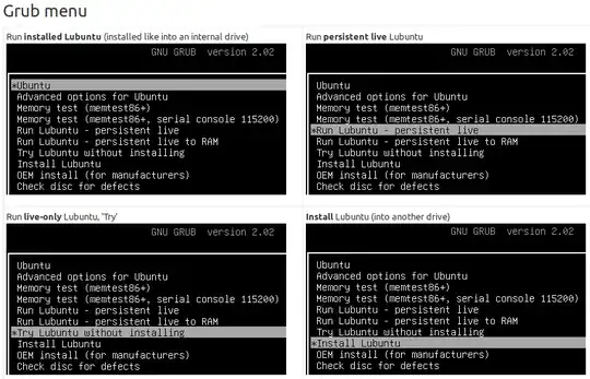

  • It is possible to create a persistent live system, that works in
  • 32-bit and 64-bit computers
  • in BIOS mode and UEFI mode
If this is what you want, the following link may help you,
mkusb/persistent#Compressed_image_file_with_a_persistent_live_system

If you are talking about an actual install, as in a full Ubuntu install rather than just a Live USB type then what you can do is use an external hard drive that plugs in via USB and install to that via the following method.
Please Note: The following steps were tested using Ubuntu Version 9.10, but has not been tested with the later versions. Use at your own risk & discretion.
What You Will Need
  1. A Computer with Internet access.
  2. A LiveCD or LiveUSB with Ubuntu.
  3. An external Hard Drive with USB capability.
What To Do
  1. Open up your computer and remove the Hard Drive.
  2. Plug in your external USB Hard Drive via the USB cable.
  3. Stick in your LiveUSB or LiveCD and then boot up your PC.
  4. Open up the boot menu, and choose to boot from the LiveCD/LiveUSB.
  5. During the installation process you should your external hard drive listed, install Ubuntu to that.
  6. Finish the installation process, turn off your PC, and put your other hard drive back into your computer.
  7. Reboot your computer, go to the boot menu and select your external hard drive and attempt to boot from it. If it does congratulations, you now have an external hard drive with a full fledged Operating System on it.
  8. Enjoy your external hard drive running Ubuntu/Linux! Please do let me know if this helps you! If not let me know about that too. :)

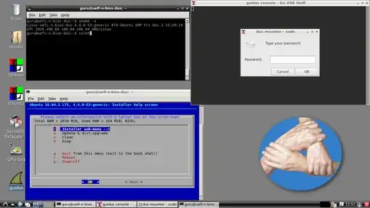

It has been described here and in many other places how to install Ubuntu into a USB drive like you install it into an internal drive. It is straight-forward to do it with the standard installer (Ubiquity), if you can disconnect or unplug the internal drive. It works in either UEFI mode or in BIOS mode, the same mode as was booted when installed.
Installed system that boots from UEFI and BIOS mode
But if you want a USB drive with an installed system, that boots in both UEFI and BIOS mode, it is more difficult. I made such systems and prepared compressed image files, that can be installed in linux with mkusb directly, or in Windows in a two step procedure, extraction and cloning (and fixing the GPT). mkusb does it all, including fixing the GPT.
The mkusb Launchpad project is here.
The systems created from these compressed image files are quite portable between computers, not quite as portable as a persistent live system, but more flexible, when you want to update and upgrade the system (kernels, drivers etc).
See the following links and links from them,
help.ubuntu.com/community/Installation/UEFI-and-BIOS
Installed systems with guidus and gparted
You find compressed image files at this link,
phillw.net/isos/linux-tools/uefi-n-bios
Look for the newest files with updated versions of the installed program packages.
If there is a temporary problem to download these compressed image files, you can try the following torrent files,
dd_text_16.04-UEFI-n-BIOS_2017-01-15_intel-4-pendrive-7.8GB.img.xz.torrent
dd_dus-lxde_16.04-UEFI-n-BIOS_2016-12-12_intel-4-pendrive-7.8GB.img.xz.torrent
uploaded at UEFI-and-BIOS/torrent where you also find a short description. [Left]click on the torrent link, get to the attachment page, and there you right-click on the link and select 'save link as' to get the torrent file.
user: guru
password: changeme
dd_text_16.04-UEFI-n-BIOS_2017-01-15:
dd_dus-lxde_16.04-UEFI-n-BIOS_2016-12-12:

  • Click Continue on the drop down.
(Optional FAT32 data partition for use on Windows machine)
  • Click "Free space" and "+".
  • Make "Size..." about 2000 MB.
  • Select "Primary".
  • Location = "Beginning of this space".
  • "Use as:" = "FAT32 file system".
  • "Mount point" = "/windows".
  • Select "OK"
  • Click "free space" and then "+".
  • Select "Primary", "Size ..." = 4500 to 6000 MB, "Beginning of this space", Ext4, and Mount point = "/" then OK.
(Optional home partition)
  • Select "Primary", "New partition size ..." = 1000 to 6000 MB, Beginning of this space, Ext2, and Mount point = "/home" then OK.
(Optional swap space, allows hibernation)
  • Select "Primary", "New partition size ..." = remaining space, (1000 to 2000 megabytes, or same size as RAM), Beginning of this space and "Use as" = "swap area" then OK.
(Important)
  • Confirm "Device for boot loader installation" points to the root of the USB drive. Default should be ok if HDD was unplugged.
  • Click "Install Now".
  • Select your location.
  • Select "Continue".
  • Select Keyboard layout.
  • Insert your name, computer name, username, password and select if you want to log in automatically or require a password.
  • Selecting "Encrypt my home folder" is a good option if you are worried about loosing your USB drive.
  • Wait until install is complete.

New installed system that boots from UEFI and BIOS mode
Portable system that boots and works in most computers
This answer describes a combination of portable systems that boots and works in most PC computers (laptops, desktops and workstations with Intel or AMD processors).
  • During the last ten years most personal computers that were manufactured and sold contain 64-bit processors, so I am focusing on 64 bit systems.
  • Lubuntu 18.04.1 LTS was selected due to the light foot-print, which helps when running from an external drive, typically a fast USB 3 pendrive or memory card, but a USB 3 SSD is a powerful alternative.
There is a
  • [persistent] live system for maximum portability, and
  • an installed system for maximum stability and flexibility (possible to update and upgrade only limited by the drive space).
  • Both systems are quite portable, stable and flexible, when used carefully.
  • The Lubuntu systems in this compressed image file were installed and combined inspired by a method originally described by C.S.Cameron. This provides the stable bootloading system of mkusb.
Live, persistent live and installed Lubuntu 18.04.1 LTS systems
The compressed image file
dd_lubuntu-18.04.1-desktop-amd64-persistent-n-installed_15GB.img.xz
contains a
  • a live part, that can be run as
    • live-only
    • persistent live
    • installer
  • an installed part (installed like into an internal drive)
UEFI and BIOS
All these operation modes work in
  • UEFI mode (including secure boot) and
  • BIOS mode (alias CSM alias legacy mode)
User and password for the installed system
  • user: guru
  • password: changeme
Download and check the compressed image file
Get the file and its md5sum at phillw.net/isos/linux-tools/uefi-n-bios
Install by cloning to a drive with 16 GB or more
Remember to check with md5sum, that the download of the compressed image file was successful.
It is straight-forward to install from the compressed image file with mkusb.
If you clone with another tool, you should run gpt-fix in order to match the gpt data to the current drive size (mkusb version 10.6.6 or newer versions of mkusb, runs gpt_zap and gpt_fix built-in).
See the detailed description at this link: Installation_from_a_compressed_image_file
Detailed description
See more details at this Ubuntu help page: help.ubuntu.com/community/Installation/UEFI-and-BIOS/stable-alternative-18.04.1
If you want to create a similar system ...
The descriptions in this link and links from it can help you create a similar system with the same method. It can also help to clone from the compressed image file and look into the details in order to get everything working.
