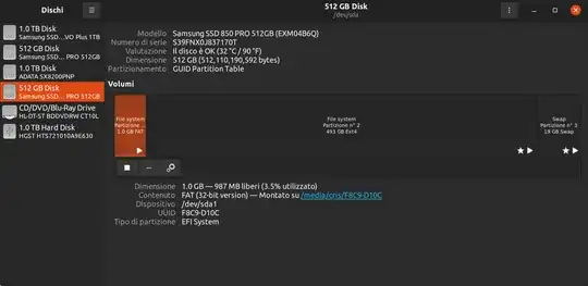

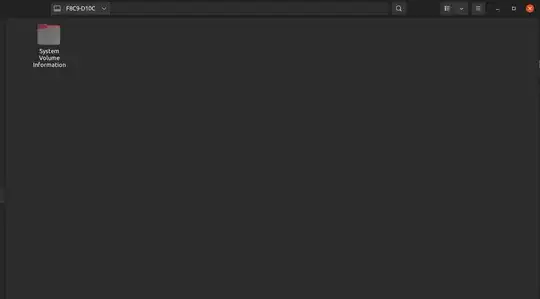

As the picture below, in the past I have installed few times the Ubuntu for differetn testing. But in the last Ubuntu OS installation on my new SSD, I devided the partition for my needs and created the FAT32 Boot Partition to save the Grub Boot. Because I have 4 SSD/Nvme with different OSes installed and separated from each other (Windows 10 Home, Windows 10 Pro , Windows 7 Ultimate and Ubuntu 21.04) , last time I'm sure 100% that I have choosen the right driver to install the GRUB EFI bootloader but could be that something happen on my old previous installations and happen that the OS it's installed in /sda partition but the Grub it's installed into the /nvme0n1p2.
If I copy the EFI folder from /nvme0n1p2 and paste it into the right SSD FAT32 Partition /sda and change the boot UUID into a file system (that now I don't remember the name), I will solve like that? or there is some other way?
The system working well, it's just to take out the extra voice on BIOS Drive Selection once I need to choose which drivers with the OS need to be start because now I have two Ubuntu selection under two SSD drivers......
GRUB wrong EFI path: enter image description here

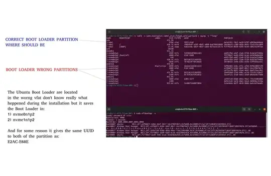

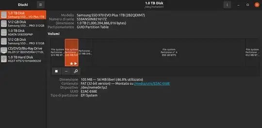

Thanks @oldfred, finally it seems that this problem related to the Multiboot it has some sense now (after using this command lsblk -o name,mountpoint,label,size,fstype,uuid,partuuid | egrep -v "^loop" ). Last time the GRUB Boot Loader it installed in wrong Partitions even if I gave - for sure - the right flag and Partition to install it (next time better to keep just one alone SSD driver connected during the Linux installation). So it seems that GUI Disk Manager was right that into the FAT32 EFI Partition it's empty, because GRUB Boot Loader it's installed into two partition as I demostrate into the PIC below and for some reason it keeps the same UUID for both /nvme0n1p2 and /nvme1n1p2, maybe it's the reson why before yesterday I have tried to take out the UBUNTU GRUB folder from one of the NVME wrong Partition and the OS still Starts, because there is another GRUB where the system it boot from the Second Windows NVME if cannot find from the first. Now, because the Operation related to the GRUB it's delicate, otherwise I risk to don't let the OS to boot anymore; I need someone more expert to Guide me step by step on it.
I believe that the first step, it's to install GRUB in the right SSD Partition/ Position and it's the /sda1 partition and then test if will boot it, and then once sure everything it's fine on it, to delete the two WRONG GRUB Boot Loader into /nvme0n1p2 and /nvme1n1p2. I have read the internet addresses forwarded, but are fragmented information that I need to collect and I'm not sure if I still to mistake on it. So, please, I need someone that Guide me on my specific situation.

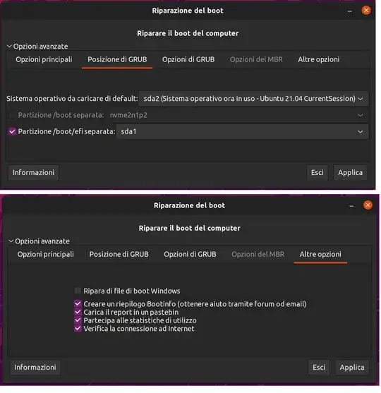

  1. Once installed the App, open it and press Advanced Options (on Down Left).
  2. Follow the Pics below (it’s in my language, but it’s understandable which Option you have to select). So, go on Second Flag - Page GRUB Location - and from the sub 3 voices on the first one go to choose your Ubuntu OS Location from the list and Uncheck the second Voice and Check the Third Voice so on the list should appear the EFI FAT32 Partition empty where should be the GRUB, in my case the SSD it’s sda, so the OS in sda2 and the GRUB need to be installed into sda1 (all the rest listed Partitions, are just the external Windows FAT32 Partitions because you have the Multiboot). After that, jump to the Fift Flag - Other Options – and Uncheck the first Voice. Then, press Apply.
  1. Once done it, reboot your system and into your Bios should appear the new Voice under start up devices sections with the right SSD/HDD device. Add as the first priority to understand if it’s working and from the BIOS disable the rest of the extra wrong SSD UBUNTU voices.
