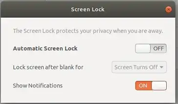

4. Disable lock screen.
To disable lock screen just follow this:
Settings -> Privacy -> Screen Lock -> change 'Automatic Screen Lock' to 'Off'
To disable lock screen through command line permanently, issue the following command:
$ gsettings get org.gnome.desktop.lockdown disable-lock-screen 'true'
If you are unhappy with the new setting you can reverse it using:
$ gsettings set org.gnome.desktop.lockdown disable-lock-screen 'false'
enter image description here Figure-1: Disable Screen Lock

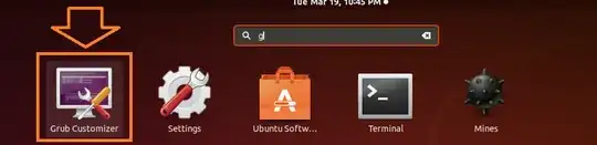

8. Install Grub Customizer:
Grub Customizer is a graphical interface to configure the grub2. The application allows the user to add, remove, freeze, rename and reorder boot menu items.
Open up terminal by hitting Ctrl+Alt+T and run following commands one by one:
$ sudo add-apt-repository ppa:danielrichter2007/grub-customizer
$ sudo apt-get update
$ sudo apt-get install grub-customizer
How to use?

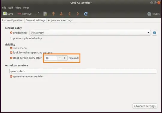

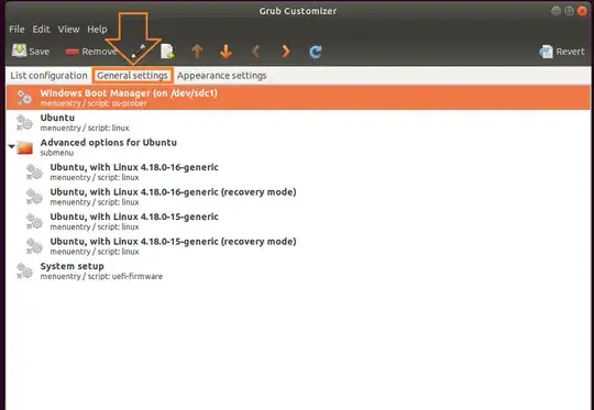

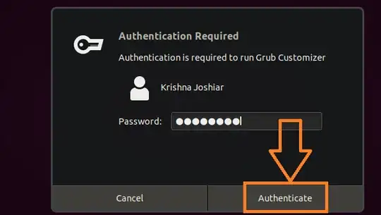

  • Once installed, hit Gnome dash and search for "G" and double-click Grub-customizer icon to open up. enter image description here Figure-2: Type 'G' in search box in order to cause 'Grub customizer' to appear
  • Grub Customizer will always request you for authentication. Type your sudo password. enter image description here Figure-3: Type sudo password authentication
  • Now using this graphical tool you change the boot order of GRUB by bringing up Windows bootloader to the top of the chain. This can be done by moving the desired loader up until it reaches the top. enter image description here Figure-4: Place the cursor on 'Windows bootloader', then right click for drop down menu to appear and use 'move up' menu item to lift 'Windows bootloader' up in the ladder until you park it on the top.
  • Once Windows bootloader parked at the top of the ladder, the first thing you should do is save the settings. There is a save menu item at the top-left and click that to save your GRUB configuration. You should never ignore this step!
  • So by default windows-10 which you have set will be booted after 10 seconds. Just click General settings marked by a red arrow to get the following figure-5, where you can alter this 10 secconds delay interval. enter image description here Figure-5: GRUB interval 10 seconds may be altered here
  • You can always explore this tool without any fear because you can always quit from the tool without saving!
  • This is how you configure Grub using Grub Customizer tool. Very reliable!

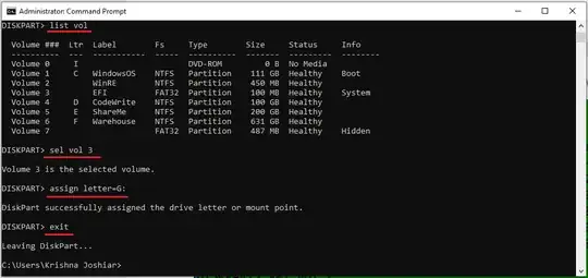

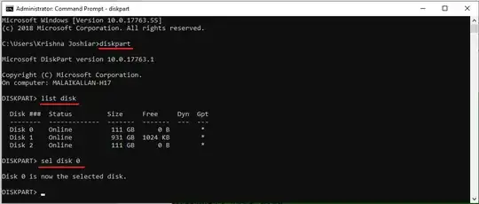

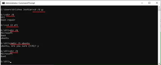

Press enter image description here + X and select Command Prompt (Admin) and run diskpart command.
enter image description here Figure-6: Using 'diskpart' to list hard drives detected on Windows 10
After the target disk has been selected, its partitions are listed, so that the partition (volume) that corresponds to the Boot EFI folder can be identified.
In figure-7 below, that partition is Volume 3. It’s usually the only volume with FAT32 in the FS (file system) column, and System in the Info column. After it has been identified and selected, you assign it an unused drive letter to make it easier to work with. In this example, I assigned it a drive letter G.
DISKPART> sel vol 3
enter image description here Figure-7: Select volume number corresponding to the EFI partition and assign a drive letter
The final task involves changing into the Boot EFI folder, listing its contents to identify what subfolder the GRUB files would be. It will be in the EFI folder. The GRUB files for the distribution that was installed will be under a folder of the same name as the distribution.
For example, if Ubuntu was installed, as in this example, the name of the folder will be ubuntu. Delete the folder using the rmdir /s command. That’s the Windows 10 equivalent of the Ubuntu Linux rm -r command.
enter image description here Figure-8: Removal of extraneous 'ubuntu' boot entry from windows-10 EFI
To make sure that ubuntu has been removed, issue dir command again:
DISKPART>dir /B
The output will show only two entries.
Exit from diskpart command.

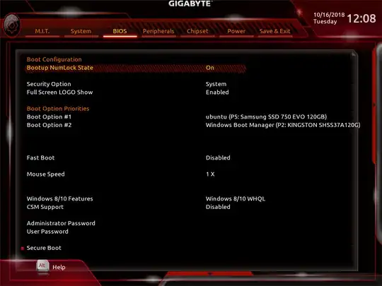

enter image description here Figure-9: GRUB has created an extraneous boot entry in SSD (Kingston) drive where in windows-10 installation exits.

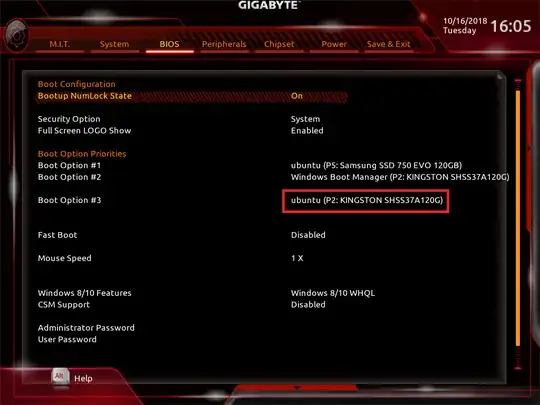

Now Look at the three boot entries in BIOS as shown below:
The Boot option#3 is the culprit which should be removed not only from SSD (Kingston) but also from GRUB boot loader:
We have already followed the steps in the beginning of Part-IV (How to delete "extraneous" GRUB files from a Boot EFI partition in Windows 10?) until now and removed the extraneous ubuntu directory from windows-10 EFI successfully.
Now restart computer and login into Ubuntu system.

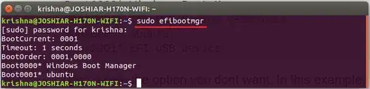

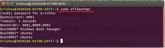

Open up terminal by hitting Ctrl+Alt+T and run following command:
$ sudo efibootmgr               # issue this command to show boot entries
enter image description here Figure-10: Output for command: 'sudo efibootmgr' showing 3 entries
Boot entry 2 should be removed. How to confirm this?

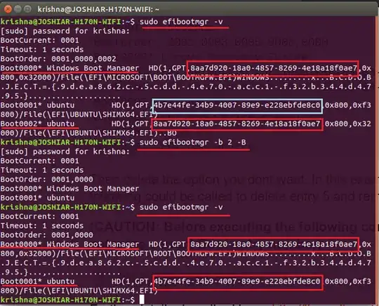

$ sudo efibootmgr -v                    # issue this verbose command
Boot entry 2 has the same UID for SSD disk as boot entry 0 which is windows loader.
$ sudo efibootmgr -b 2 -B               # where 2 is the boot entry Boot0002.
Now the entry has been removed.
enter image description here Figure-11: The process of removal of the extraneous boot entry created by GRUB
To confirm the removal, just issue the following command:
$ sudo efibootmgr                   # issue this command to display boot entries
enter image description here Figure-12: Confirmation of removal of extraneous boot entry created by GRUB
From the figure-12, it is clear that only two entries are present rather than three. Just see the entries marked with *.
Let is finally see BIOS setup screen below figure-13, to make sure that only two boot loaders are present.
enter image description here Figure-13: The extraneous 'Boot Option #3' has been totally removed from BIOS (compare with Figure-9).
