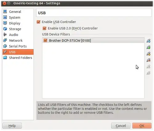

3. Activate USB support in VirtualBox Manager
Shut down your virtual machine and open USB settings in the VirtualBox Manager. Tick Enable USB Controllerand USB 2.0 (EHCI) Controller or USB 3.0 (xHCI) Controller.
If these settings are greyed out, you need to shut down the virtual machine.

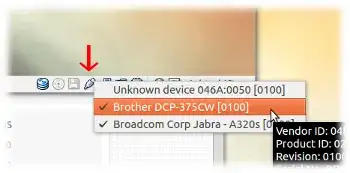

4. Select host USB device for access from the guest
To grant access to USB devices we need to select a device to disable in the host and to enable in the guest (this is a precaution to avoid simultaneous access from host and guest). This can be done from the panel Devices menu or by right mouse click in the bottom panel of the VirtualBox Manager on the USB icon:
Tick the device you need in the guest, untick it if you need it in the host. If you can't see your USB device in that list, it means that VirtualBox cannot access your host USB devices. Make sure your user is added to the vboxusers group and that you restarted your host.

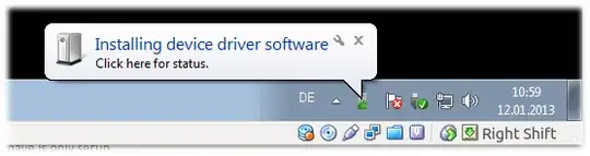

The selected device will immediately be accessible from the guest. A Windows guest may need additional drivers.
  • Windows 7 needs an additional driver for USB 3.0 support.
  • Windows 10 does not accept an NTFS formatted USB pen drive.
[optional] Use USB filters for permanent access in the guest
By defining USB filters we can define USB devices that will automatically be presented to the guest when booting the guest OS.
Click on the green + symbol on the right to add a known device.
Note, that some devices may lead to a boot failure of the guest. We can not use these devices for filters.

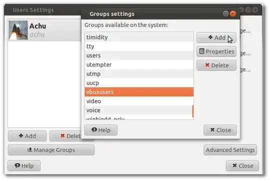

  • Install gnome-system-tools b/c The old Users and Groups GUI is not available by default on 11.10
    sudo apt-get install gnome-system-tools
  • After the installation finished Open user and groups from launcher
  • Select your username click on Manage Groups and select vboxusers and click add.
  • logout/login to be able to use USB in VirtualBox.

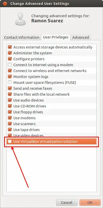

I had the same problem and fixed it by clicking in the VirtualBox group of my user. You can access it installing gnome-system-tools (it does not come with Ubuntu 12.04 Precise Pangolin), either via the Ubuntu Software Center, Synaptic or by typing in the terminal:
Remember that to paste in the terminal you have to use Ctrl+Shift+V, as opposed to Ctrl+V.
You will probably have to enter your password to allow the installation and add a Y (as in yes) to finish installing the packages.
Then you head to your Dash home and type users. You will see two applications. The good one is Users and Groups.
You then have to click on Advanced settings for your user and enter your password.
Now you will be shown a window with three tabs. Click on User Privileges. Find the line that says Use Virtualbox virtualization solution and then OK.
Change user group privileges
You may be asked to enter your password again. Then click on Close and log-out and log-in again.
When you start VirtualBox, you should see a whole bunch of new USB devices.
Good luck!
