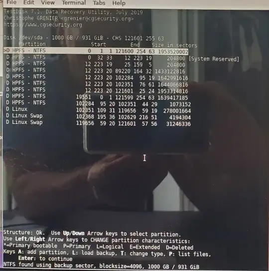

Results from TestDisk scans of /dev/sda enter image description here
Results from a deeper scan of the Linux partition: enter image description here
Just crawled inside computer & checked. Harddrive is a 1 TB Hitachi mfgd Aug., 2009.
It appears that there are no recovery options available. I don't have a "backup boot sector". I've gone thru the Testdisk documentation and it appears that what I want to do isn't available. That would be to fix the Linux partition EXT4 and add Grub to it. I'm guessing that I can do a clean Linux install from a CD and maybe install Grub there?

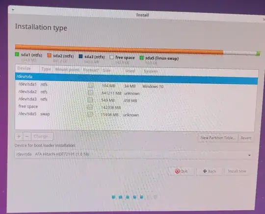

Parttitions found on HardDrive

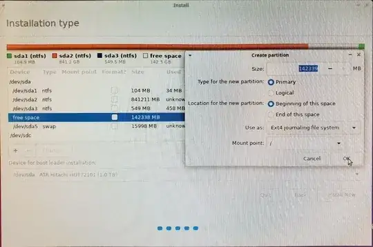

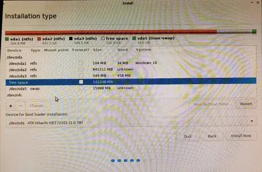

Latest update: I decided to reinstall XUbuntu from the "Live CD"; which is neither live nor a CD. It's the XUbuntu 20.04 boot DVD. The "Live CD" wouldn't pick up a wireless Network, but I plugged in a wire & it worked fine. I selected the custom install option and it picked up & installed to it's previous 142 GB partition. There was no keyboard at boot, thus I had to default to XUbuntu OS. After boot I was able to have some keyboard commands and I did the apt-upgrade & changed my Grub to load Windows. Special characters don't work so I have to access Stack Exchange from a cellphone.

Windows in BIOS mode, is known to update partition table and "forget" to include a Linux logical partition. Data & partition is still there, but you have to update partition table to include ext4 partition and then you can reinstall grub. Without partition grub has nothing to boot.
You can use parted rescue or testdisk
Parted rescue seems easier than testdisk
