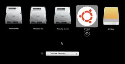

Bonus: Add a partition for Macs on an installation with GPT
I found that the very new Mac (Mac Mini A1347 EMC 2840) I was testing with could boot from a standard FAT32 ESP, even from MBR! Anyways, here we go:

    To boot Ubuntu from external media on a Mac you would now just need to press the option key or Alt on Windows keyboards and select the right disk.
    Mac Startup Manager showing volumes and Ubuntu logo

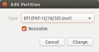

To be as accurate as possible, the boot flag isn't important to GRUB, by default GRUB searches for UUIDs to find the right filesystem to boot from. Setting the boot flag or the bios_grub flag in GParted usually sets a type (MBR) or GUID (GPT) for the partition.

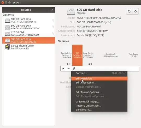

The benefit of setting the correct type or GUID, besides having a properly working setup, is that these partitions will be hidden in the filemanager. The easiest way to check and change types and GUIDs is via Disks (gnome-disks).
screenshot showing drives and partitions in gnome-disks
screenshot showing edit partition dialog in gnome-disks

  • 0xef is the type code for ESP in MBR for use with fdisk
  • ef00 is the abbreviated type code for ESP in GPT for use with gdisk
  • ef02 is the abbreviated type code for BBP in GPT for use with gdisk
Wikipedia has a big list of GUIDs for GPT.
