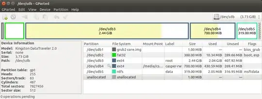

Simple Hand Made Persistent USB
If you like learning experiences, you can create a multi partition, persistent USB that can install Ubuntu, from scratch.
  • Boot Installed Ubuntu or Live USB.
  • Insert Target USB.
  • Start GParted.
  • Create a GPT partition table on Target USB.
  • Create a 1MB BIOS boot partition on the left, formatted as unformatted.
  • Add a 300MB FAT32 EFI boot partition next to it.
  • Add an ext4 root partition large enough for the Ubuntu ISO's contents, (~ 3GB for 20.04).
  • Create an ext4 partition labeled casper-rw
  • Add a NTFS data partition if desired.
  • Apply all operations.
  • Flag partition 1 bios_grub.
  • Flag Partition 2 boot, esp
  • Close GParted.
