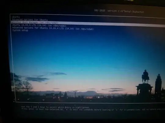

Here is an example of what my grub bootloader shows me:
I mention all this because you say you 'don't want to replace the Windows bootloader' but unless there is a particularly complicated reason for why you don't wish to do this, then having the grub bootloader installed on your Hard Disk should not cause any problems.
By changing the grub default choice, you will have almost the same behaviour that you are after, but with a short delay of a few seconds as grub waits for you to choose.

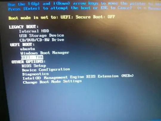

(Something worth mentioning is that if your Windows installation is using UEFI, then when you are installing Ubuntu you will want to press f12 to get the 'one-time boot menu' up and then select the USB under the UEFI Boot options, to ensure that Ubuntu is installed as UEFI also.)
Here is a picture to show you what I mean, with the 'UEFI: TDK' being the USB stick I am wanting to use:
