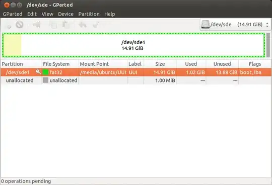

  3. Start "GParted Partition Editor" from the Ubuntu Dash. This partition manager is default installed in 13.10.
  4. Insert the other USB drive, wait a short moment and do a refresh in GParted (Ctrl+R). You will notice that a new device is added at bottom of the list of devices. Check that the size matches with the target USB drive. Select this device (see example picture below, the device name can be different on your system).
  5. Check that the mount point (/media/ubuntu/UUI) is identical as in above picture.

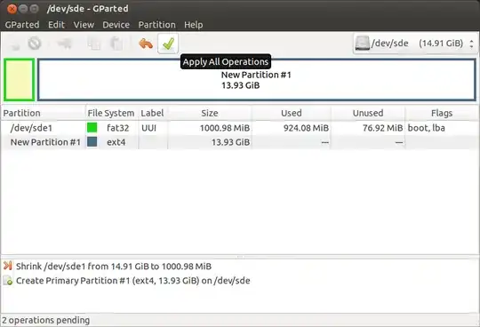

  8. Right-click on the partition and select unmount. You will notice that the Mount Point is no longer displayed.
  9. Right-click on the partition and select Resize/Move. Select New size: 1000. This will leave some space to store additional or updated files. Click "Resize/Move". An "unallocated" partion will appear
  10. Now create a new partition for the persistent storage. Select the unallocated partition and right click on New.
  11. Select file system “ext4“ and label casper-rw and click Add.
  12. Check if everything looks OK and click on the green check mark to apply all pending operations.

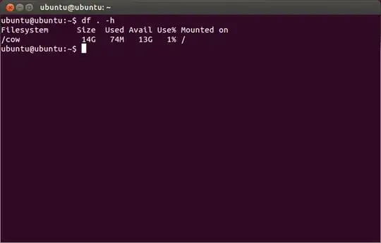

  14. Open a terminal (Ctrl+Alt+T) and type the following command:
    df . -h
    Check that the Avail size matches with the persistent partition size you created.

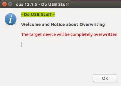

After you run the command the GUI will open. Follow these steps next:
  • Screen 1: Note the warning and click OK

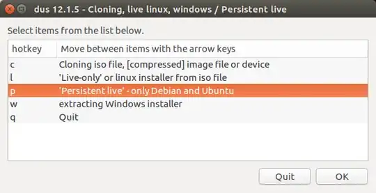

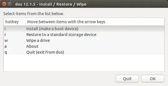

  • Screen 2: Double-Click on the i option Install(make a boot device)
  • Screen 2: Double-Click on the p option Persistent Live and select the .iso file.

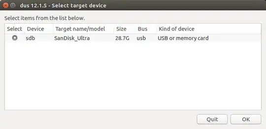

  • Screen 3: Tick the device you want to install to and click OK

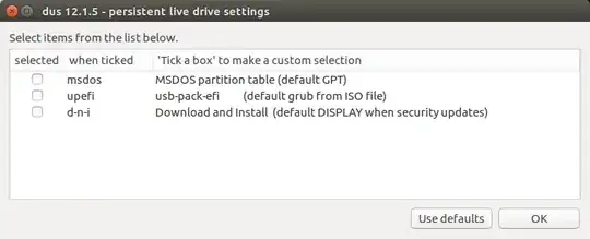

  • Screen 4: Just click Use defaults and let mkusb decide what's best. (Or choose, but wisely.)

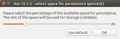

  • Screen 5: Enter the percentage of USB drive space you want to allot for persistence file-system. The remaining will later show up as portable storage device.

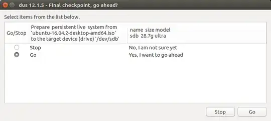

  • Screen 6: Double check you have selected the right device and settings. Tick the Go radio button and click Go.

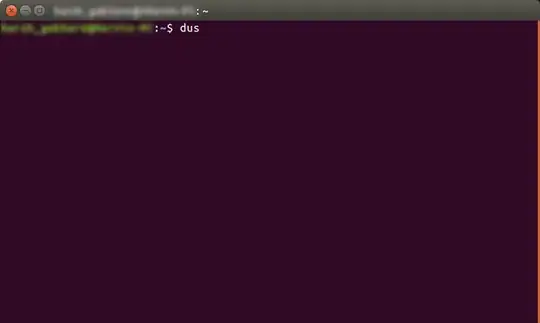

Run the command in terminal:
Note the warning and click OK:
Welcome and Notice
Double-Click on the i option Install(make a boot device):
Task To Perform
Double-Click on the p option Persistent Live and select the .iso file:
Live-only or Persistent
Click on the USB drive to make persistent. I want to use my 32 GB one so I mark the radio button:
Select_target_device

Enter a percentage of the drive to reserve for persistence. Mine is a large (32GB) so I allot only 20% ~ 6GB. The remaining space will be turned into an empty portable drive:
Enter Space for Persistance
Double check very carefully and confirm. You don't want to mess up another drive.
Double check and confirm

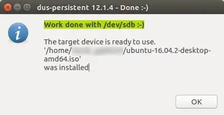

If all goes well you will be greeted by a nice green finished screen:
Finished Successfully
