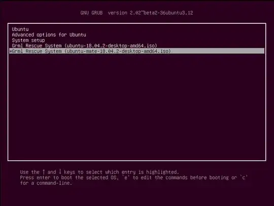

Restart Computer. You will see the grub menu with the choices:
Yours may be a bit different. The top choice Ubuntu is Ubuntu in Disk A. Look for Grml Rescue System towards the bottom of the menu
  1. Select Grml Rescue System (name of the ISO file).

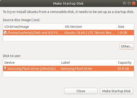

Alternately Use USB Disk (or Stick) C
Create an installation USB using the Startup Disk Creator in Ubuntu (booted from disk A).
Steps are almost the same. I am omitting the pictures:
