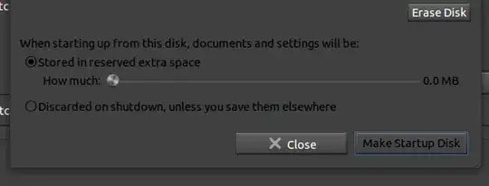

What you actually need is called Persistence. With persistence, the changes you make are saved. Depending on the tool you use to make, the name varies. In Ubuntu's Startup Disk Creator:

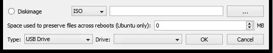

That "Stored in reserved ..." is about persistence. In Unetbootin:
The "Space used to preserve files ..." is about persistence.
