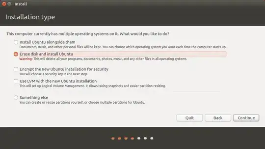

How to install to your 128G PenDrive:
First choose the option to **Erase disk and install Ubuntu. It's shown on the image below. When you click on continue on this screen, no changes will happen on any of the drives. It will give you an option to select the drive to erase and install.

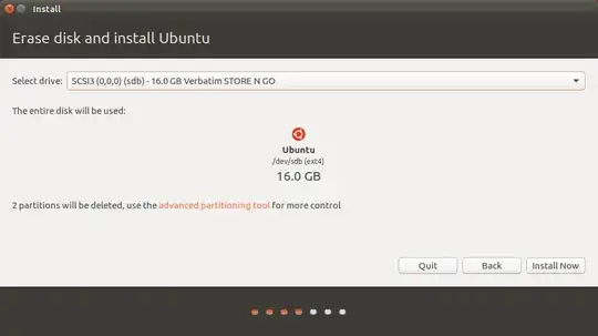

This is the screen where you select the drive that where you want the install to be applied. This is the drive that will be erased and replaced with Ubuntu. This screen has a drop-down for the selection. When you check the drop-down options it will show you the specifications of the drive such as /dev/sdX. X is the drive letter, whereas if it were an a, that would be your internal hard drive.
The info of the drive will also include the drive size and the drive manufacturer. In the case of the image, this is a 16G, /dev/sdb, Verbatim drive. It's not showing, but my drive /dev/sda is a 500G Seagate drive. After clicking continue you will get the screen below: enter image description here

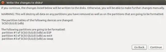

After clicking Install Now the next screen will show the actions to be performed. No changes has been written up this point. The changes will be written if you click Continue after reading this warning. If you deside not to use this option, you can click to Go Back and choose something different. enter image description here
