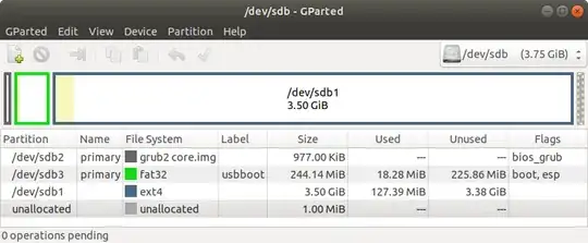

  • When the "Something Else" option opens select Target USB for Bootloader installation. This is important.
  • (Optional Data Partition), Select the empty space on the Target drive and click the plus sign to create a FAT32 partition with mount point "/Windows". Leave at least 6GB up to 100GB empty space for root partition.
  • Select the empty space on the Target drive and click the plus sign to create an ext4 partition with mount point "/".
  • Select Install now, confirm partition to be formatted, enter location, name and password.
  • When install is complete copy /boot/grub/grub.cfg from the root partition to overwrite /boot/grub/grub.cfg on boot,esp partition.
  • If the Target USB was created using Rufus/Etcher or in UEFI mode reinstall GRUB for BIOS boot:
    sudo mount /dev/sdx3 /mnt
    sudo grub-install --boot-directory=/mnt/boot /dev/sdx
