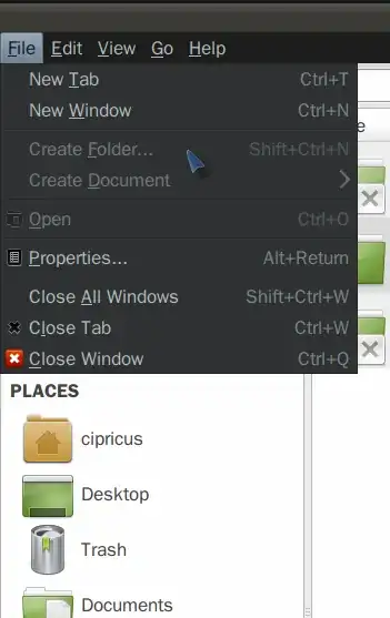

All went well until I noticed that in Thunar it was not possible to create new folder (or file) - the option was greyed out - on the external drive (while on the ntfs partition all was well):

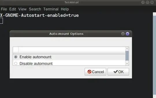

So, instead to use anymore PySDM, I suggest you to use AriOS Automount (.deb) (see here how to install a ".deb" file):
AriOS Automount is a small utility [...] and its main advantage over PySDM is that it doesn't require any kind of configuration: just install it and you're done, all your partitions (it should work with any kind of partition: EXT4/3/2, NTFS, FAT and so on) will be automatically mounted the next time you log in.

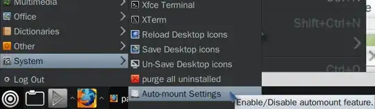

AriOS Automount works without touching /etc/fstab and it can be enabled / disabled either from the Startup Applications or via the menu, by launching "Auto-mount Settings".
Source: How To Mount Partitions Automatically On Startup In Linux ~ Ubuntu / Linux blog.
In Xfce "Auto-mount Settings" appears under Menu/System
And can be enabled/disabled easily

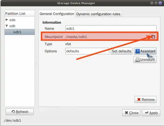

If I have not convinced you and you sill want to use PySDM, try to change the mount point to /media/$user/devicename (/media/cipricus/SAMSUNG, respectively /media/cipricus/3060-0887/):
PySDM
And:
PySDM
