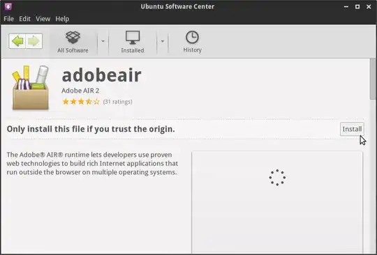

Ubuntu 14.04 - 32 and 64 bit - easy .deb install
Because of the way that multiarch works, you can can now simply install the i386 .deb file on newer 64bit Ubuntu and it will automatically install the right dependencies. (Also the 64 bit .deb is just the 32bit repackaged with a dependency on ia32-libs)
  1. Download the 32 bit(yes even for your 64 bit Ubuntu) deb: http://update.devolo.com/linux/apt/pool/main/a/adobeair/adobeair_2.6.0.19170-devolo1_i386.deb (Thanks to yuvilio's answer) The 64 bit package on the same site is a repackaged version of the 32 bit, you will have problems if you use the 64 bit package instead, use the 32 bit package for both 32 and 64 bit systems Ubuntu 13.10+.
  2. Open in software center, click Install
    enter image description here Ignore the warning about package quality
