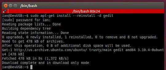

For example: I want to install gedit (which is included with Ubuntu normally so it won't download tons of dependency .deb files). But I have a system that, for whatever reason, doesn't have gedit and has no internet connect.
So first, on a computer connected to the internet, I run apt-get install --reinstall -d gedit (because if you try running apt-get install -d gedit on a system with gedit already installed to the latest version it just tells you it is already installed), which then goes through the normal process of downloading the package (in this case there are no dependencies), and then stops.

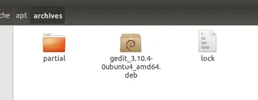

Then I locate the file under /var/cache/apt/archives/ ...

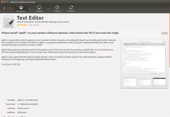

... and move it to the computer which needs gedit installed and install it, in this case using the Software Center.
Or I could install it using cd /var/cache/apt/archives and dpkg -i gedit_3.10.4-0ubuntu4_amd64.deb
