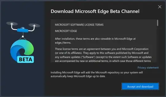

    Screenshot of a portion of https://www.microsoftedgeinsider.com/en-us/download/
  3. Read the license terms and then press Accept and download.
    Screenshot of a portion of https://www.microsoftedgeinsider.com/en-us/download/ after clicking on Download under the Beta Channel

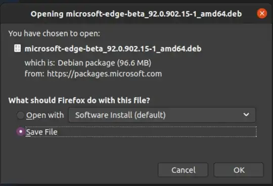

  4. A dialogue box might appear in Firefox depending upon the settings. Choose Save File and click OK.
    Screenshot of dialogue box in Firefox

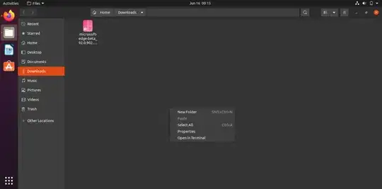

  5. Open the folder where the .deb file is saved. Right click (not on the file) and choose Open in Terminal.
    Screenshot of right-click options in Nautilus

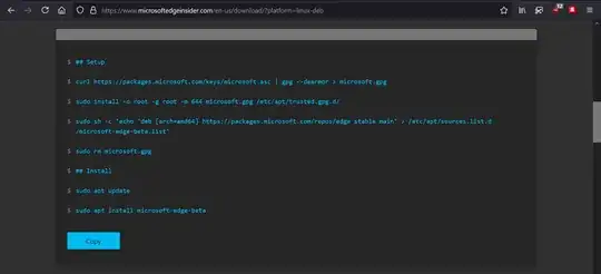

Method 2
Screenshot from https://www.microsoftedgeinsider.com/en-us/download/?platform=linux-deb Screenshot from https://www.microsoftedgeinsider.com/en-us/download/?platform=linux-deb
  1. Open Terminal. Execute:
    curl https://packages.microsoft.com/keys/microsoft.asc | gpg --dearmor > microsoft.gpg
    If curl is not installed, run sudo apt install curl and then run the above command.
  2. Run:
    sudo install -o root -g root -m 644 microsoft.gpg /etc/apt/trusted.gpg.d/
  3. Run:
    sudo sh -c 'echo "deb [arch=amd64] https://packages.microsoft.com/repos/edge stable main" > /etc/apt/sources.list.d/microsoft-edge-beta.list'
  4. Run:
    sudo rm microsoft.gpg
  5. Run:
    sudo apt update
  6. Run:
    sudo apt install microsoft-edge-beta
