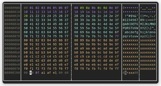

I have written hextazy an hexadecimal editor with colors written in rust.
It has the following features:
  • colored output, based on the byte value.
  • search, for both hex values and ascii strings.
  • undo and redo (Ctrl+Z, Ctrl+Y).
  • insert mode (Ctrl+J)
  • delete byte (Del key, only in insert mode)
  • jump to an address with the command :0xaddress.
You can find pre-compiled binaries on the release page.
The project is developed on Github here: https://github.com/0xfalafel/hextazy
Hextazy hex editor
