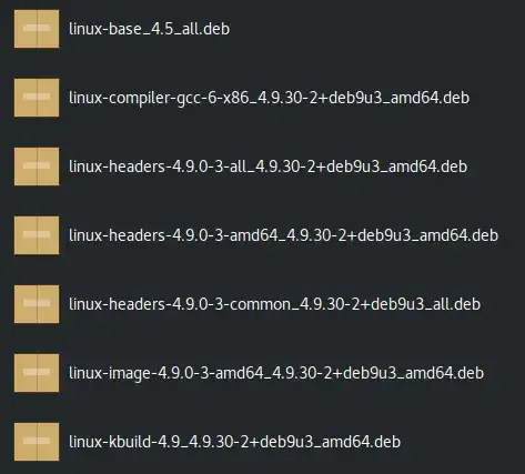

Is there an analogous install route for the Debian stretch kernel?? I have tried but there seem to be a lot of depends, and I can't get right combination of files and install sequence. Here is an image of the files I downloaded from Debian, but could not get right.

you can get the kernel here: https://packages.debian.org/stretch/linux-image-4.9.0-3-amd64
and links for the headers, compiler, and kbuild here: https://packages.debian.org/stretch/linux-headers-4.9.0-3-amd64
Install linux-base, then linux-image
then common headers, compiler and kbuild
then headers-amd
header-all shouldn't be needed.
If you are not building any kernel modules, then the headers, compiler and kbuild are not needed.
