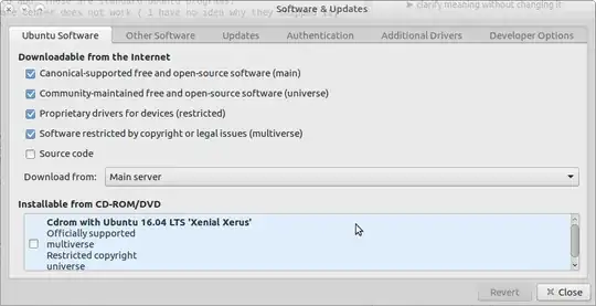

Do not listen to the other complex answers. All of the files are available from the standard ubuntu repos. There are no ppa's to add. These are standard Ubuntu programs. The software center does not work ( I have no idea why they shipped it). That is why you cannot do anything.
However, you will need to checkmark all of the boxes in the software and updates applet: enter image description here
Also it is good to go to the next tab and check off the sources is OtherSoftware for canonical partners. This will give you skype and some other things. (Hit the "Super button" or "windows" key and type "software" to get the screen above.
