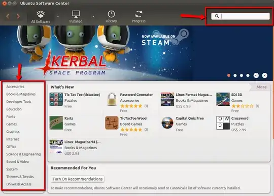

Ubuntu Software Center
You can search for an application, or go through the categories:

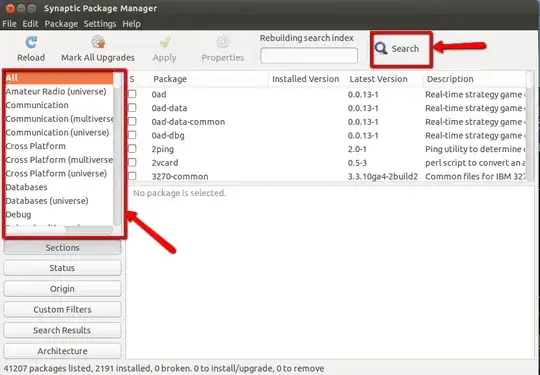

Synaptic Package Manager

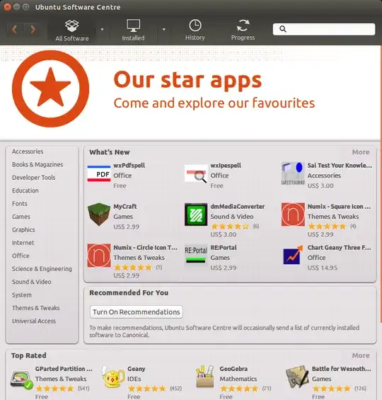

2. Installing packages via a basic graphical method
Ubuntu Software Center is a one-stop shop for installing and removing software on your computer.

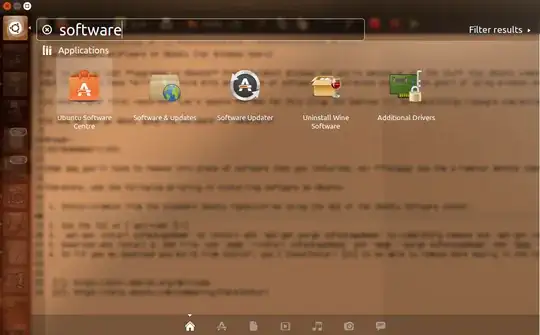

    Install/remove from the standard Ubuntu repositories using the GUI of the Ubuntu Software (Center).
    As per below screen shot, click the dash in the upper left corner, type software, click the Ubuntu Software(Center).
    Opening Ubuntu SW Center
    The Ubuntu Software (Center) opens:
    Ubuntu SW Center Start
    and you have a ton of application categories on the left to choose from. Or type the name of the software in the search box in the top right corner (which is what we'll be using)

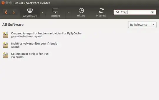

    Crap software
    I'm as amazed as you, but there is indeed crap software for Ubuntu, :-) so just click the crap you want, click on "Install", wait a bit and done!
    To remove software using this method, click on the "installed" button on the second screen shot, click the crap you want to uninstall and click the "Uninstall" button! Easy-peasy.

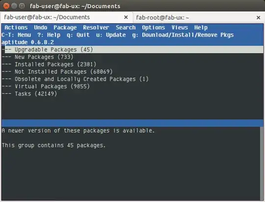

  3. (Intermediate users, 6 months-1 year of experience)
    Use the TUI of aptitude
    Press Ctrl+Alt+T to go to a terminal and type:
    sudo aptitude
    and press Enter
    If you get aptitude: command not found, type:
    sudo apt install aptitude
    to install aptitude and wait until nothing moves any more and then type:
    sudo aptitude
    to start it.
    screenshot aptitude
    This is still kind of familiar: you can use the mouse, but it's like you're back in 1988 before the WWW was invented. And now comes the first hurdle: RTFM for aptitude by typing:

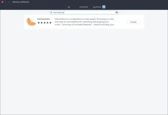

Installing from Ubuntu Software
You can install applications from the Ubuntu Software application present in your launcher:
Ubuntu Software Installing from Ubuntu Software
Here you can search for applications which are present in Ubuntu's repository.

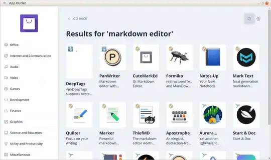

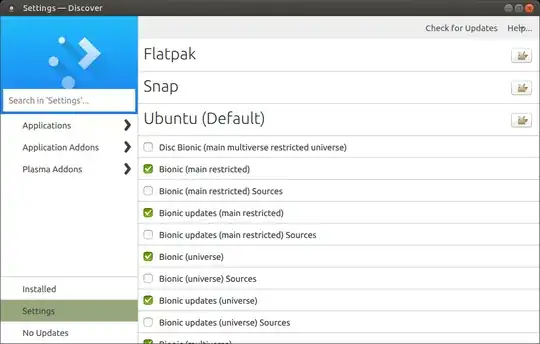

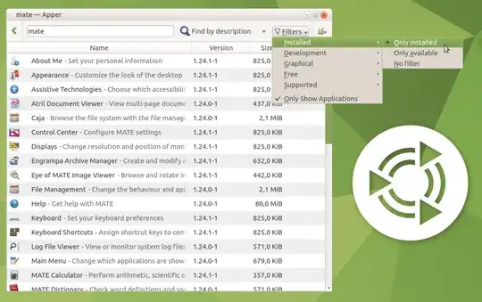

Comparison table of the tools presented in the below answer
↓ Name / Format → deb Snap FlatPak AppImage
apt/apt-get + - - -
snap - + - -
flatpak - - + -
Synaptic + - - -
Muon + - - -
GDebi + - - -
Y PPA Manager + - - -
Plasma Discover + + + -
Apper + - - -
AppImageLauncher - - - +
App Outlet - + + +
1. Muon as Synaptic replacement
As we already know modern Synaptic is buggy, it often and ineffective rebuilds search index (see bug 1685376 and discussion on community.ubuntu.com).
So I suggest to use great tool from KDE - Muon.

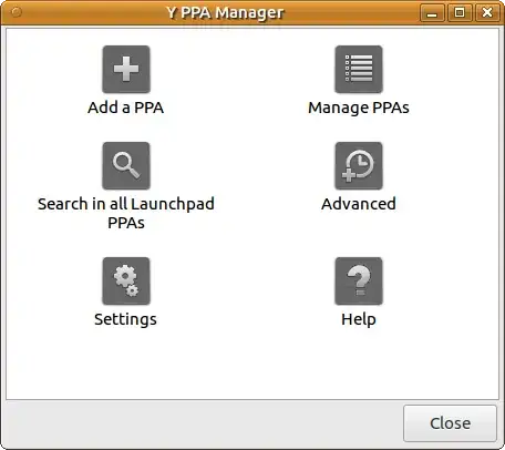

3. Search and install software from Y PPA Manager (y-ppa-manager)
Sometimes software is not packaged in official Ubuntu repositories. In this case we need third-party repositories known as PPAs (Personal Software Archives). There are a lot of them on LaunchPad. You can use special page https://launchpad.net/ubuntu/+ppas for search.
But it is difficult to find such repository for exact package. In that case special utility - Y PPA Manager may help.
y-ppa-manager on Ubuntu MATE 16.04.5 LTS
One can install it with
sudo add-apt-repository ppa:webupd8team/y-ppa-manager
sudo apt-get update
sudo apt-get install y-ppa-manager
After installation it will be located in Applications -> System Tools -> Y PPA Manager. The most useful thing is Search in all Launchpad PPAs - you can search packages by name, then add its PPA and install needed package.
But anyway be careful with software, obtained from PPAs. It may trash your system and cause unpredictable behavior of system.

4. Plasma Discover as GUI for Snap, FlatPak and APT
If you are running Ubuntu 18.04 LTS (with any desktop), then you can install Plasma Discover to it and use as GUI for Snap, FlatPak and APT. See this Q&A for details:
sudo apt-get install plasma-discover \
plasma-discover-flatpak-backend plasma-discover-snap-backend \
qml-module-qtquick-controls qml-module-qtquick-dialogs kdelibs5-plugins
and you will get universal GUI:

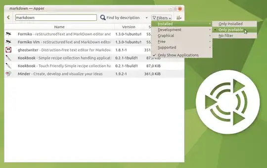

5. Apper
The Apper is installable by sudo apt-get install apper breeze on modern Ubuntu versions since 18.04 LTS.
Note: along with its usual functionality, it is very useful application to list installed
apper-installed
or search for
apper-search
the desktop (GUI) applications.

7. App Outlet as GUI to search Snap, Flatpak and AppImage
There is a new, fresh project named App Outlet.
It is installable from deb, AppImage and Snap; it allows to search and install applications:
search for Markdown editor in AppOutlet
