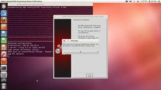

I can not install fglrx ATI drivers/Catalyst 12.8. I have tried installing AMA Catalyst 12.8 using this guide: http://www.upubuntu.com/2012/08/install-amd-catalyst-128-on-ubuntu.html
When I reach the part of installing with sudo sh amd-driver-installer-8.982-x86.x86_64.run , I get the following error:
When I run it using the --force option, I get this message: enter image description here
How can I fix these errors and install Catalyst 12.8?
I resolve the problem. Catalyst 12.8 dosent support Ubuntu 12.10. You have to download and install Beta Version Catalyst.
Resolve the problem and correctly instalation Catalyst. It is a Bug.
First if you have instaled drivers pls unistal them. After this enter comand.
sudo apt-get install linux-source
sudo apt-get install linux-headers-3.5.0-17-generic
After this install driver from System settings/software resources/additional drivers and select AMD graphicks accelerator
As mention on the page open terminal Ctrl+Alt+T, and;
Uninstall first the old driver with the following commands:
sudo sh /usr/share/ati/fglrx-uninstall.sh
sudo apt-get remove --purge fglrx fglrx_* fglrx-amdcccle* fglrx-dev* xorg-driver-fglrx
Install base on this page:
cd /tmp
chmod +x amd-driver-installer-8.982-x86.x86_64.run
