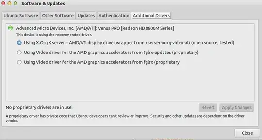

So it's there, right? Addition Drivers also says I'm using AMD:
Trying to install fglrx and using that instead (see above options) results in a low-graphics mode on reboot. Every time. So I remove fglrx and everything goes back to normal.
