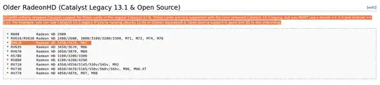

What is not true because wiki says that:
  • RV620 Radeon HD 3450/3470, M82

You do not refer to the release version that you are using, assuming > 12.04 LTS
Your card is not supported by the latest releases of the ATI driver.
You will need to use Ubuntu 12.04 LTS to install the legacy drivers or use the default already present and working, open source release of the driver. You cannot use fglrx drivers for our card on a Ubuntu release higher than 12.04 LTS.
