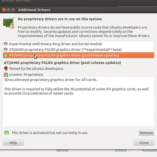

I have tried several solutions but nothing works. First of all, I'm using ATI Radeon HD 5400. The first monitor (which works) is connected to the graphic card by DVI, the second monitor (which isn't detected) is connected to the motherboard by VGA. One important point - when I used Windows (yesterday?) the two monitor worked together fine.
What I've done until that moment:
  1. Followed by the instructions here: https://help.ubuntu.com/community/BinaryDriverHowto/ATI#Installation_via_the_Ubuntu_repositories. Installed fglrx by writing sudo apt-get install fglrx. Then typed fglrxinfo in the Terminal and got:
    display: :0  screen: 0
    OpenGL vendor string: Advanced Micro Devices, Inc.
    OpenGL renderer string: ATI Radeon HD 5700 Series
    OpenGL version string: 4.2.11903 Compatibility Profile Context
  2. Tried that solution: https://askubuntu.com/a/281117. I installed:
    and added in Xorg.conf the following line: Virtual 3600 3600.
  3. System Settings > Details > Graphics displays Driver: VESA:JUNIPER
  4. The second monitor isn't detected either by the Catalysit Control Center nor by System Setting > Display.
  5. $ lspci | grep VGA displays >> 01:05.0 VGA compatible controller: Advanced Micro Devices [AMD] nee ATI RS880 [Radeon HD 4200] 02:00.0 VGA compatible controller: Advanced Micro Devices [AMD] nee ATI Juniper [Radeon HD 5700 Series] The meaning is that it knows about the existence of the on-board graphic - Radeon HD 4200 (?).
