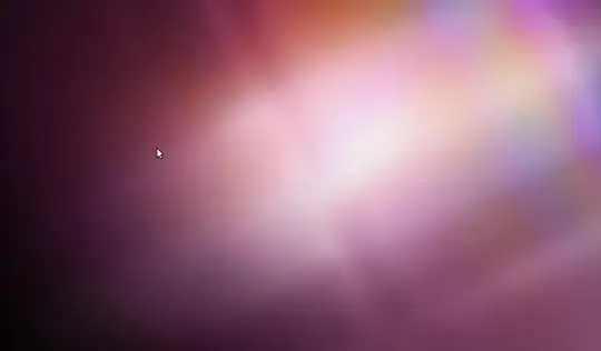

When I login, nothing happens.
I am presented with my desktop wallpaper.
Blank desktops suck
No Dash, no Launcher, nothing.

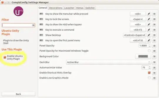

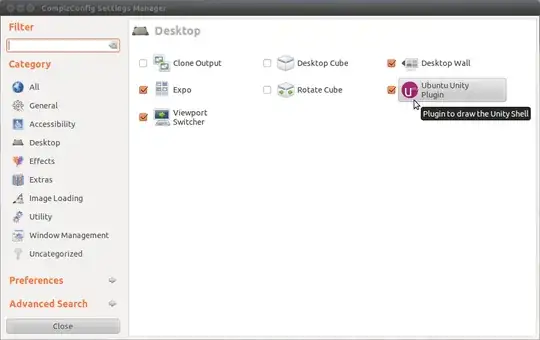

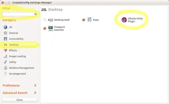

  5. Find the Unity plugin. Enable it (detailed instructions just below). You will be asked "Ubuntu Unity Plugin requires the plugin OpenGL. Enable Ubuntu Unity Plugin / Enable OpenGL"
    • 1) To enable the Unity Plugin: Click "Desktop" (left side) --> Ubuntu Unity Plugin. You can also type "unity plugin" into the "Filter" search box. Screenshot: enter image description here
    • From here, click the checkbox for "Enable Ubuntu Unity Plugin": enter image description here

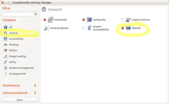

    • 2) To enable OpenGL: click "General" (left side) --> then check the box for "OpenGL", as shown below. You can also type "opengl" into the "Filter" search box to bring it up. enter image description here
