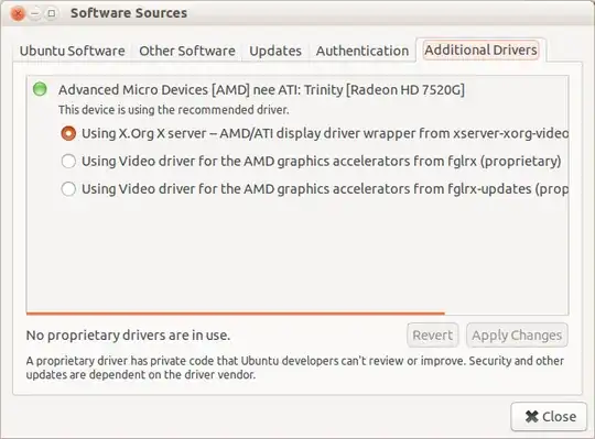

First, run the Additional Drivers program. Open Software Sources, it's the last tab. 12.04 default AMD were unusable on my laptop, thus I was forced to use proprietary drivers. Now in 12.10, the default drivers run beautifully out of the box.
If not, install Catalyst 12.8, it is updated AMD driver release in August, so fairly new and up to date. Instructions here: What is the correct way to install proprietary ATI Catalyst Video Drivers (fglrx) directly from AMD?
Power management could be your next option to look into. My favourite tool, which is easy and powerful, is Jupiter Applet. http://www.jupiterapplet.org/ Having better power management can greatly reduce the heat of your computer, and in turn the fan rotations.
