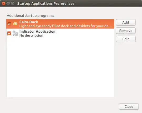

Open Startup Applications from dash. This should give you something like this(but not exactly like this) :-

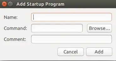

Press Add. You will get this :-
Give some name you like. Then press browse and select the script which we created(Remember that we saved it as /usr/bin/lighdmxrandr.sh ). If you want give a description. Then press Add. Before closing Startup Applications check if the entry you just added has a tick mark next to it. Now reboot your PC. This should get you the desired resolution in both the login screen as well as in the desktop.
