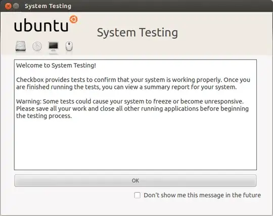

Try the Live version of the USB/CD. Linux kernel typically has the drivers you need. The live version of Ubuntu, aka Try Ubuntu, is the default option on the install disk. Once running it allows you to run "System Testing" your computer for compatibility.
System Testing: check if Ubuntu has the drivers for your system
