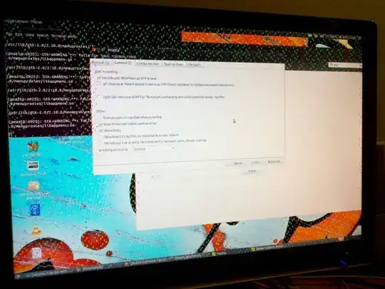

In an effort to gather more information I decided to re-install fglrx. I used these instructions to install. After only a couple of minutes it froze again, but this time the green pixels lasted much longer. I was able to grab a picture with my phone, which is shown below. I was still able to interact with the computer while this was happening. I attempted to open the terminal and get the GPU temp and load, but the pixels disappeared and the system locked up before I could. I was able to connect via an ssh session though. The logon message reported that it was not able to write to my .Xauthority file. Using top I saw that Xorg was running at 100% CPU usage. I was not able to stop Xorg with any of: sudo kill -9 1779 where 1779 was the PID of Xorg, sudo kill -9 -1 which disconnected me from the ssh session ( thought I was able to reconnect later ), or sudo service lightdm restart which made the whole screen turn white though. I then did sudo reboot and used the command line to revert to the open source drivers and to remove .Xauthority so I could log back in.
