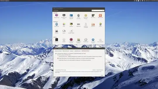

Go to System Settings in the Dash, or click the little gear in the launcher. After that go to "Software Updates" and then click on the "Additional Drivers" tab.
Now select the fgrlx-updates radio item.
That should do it. I have a 7950 and it works perfectly with that. Can't speak directly to your card, but this is the easiest and best way to install any video driver really.
